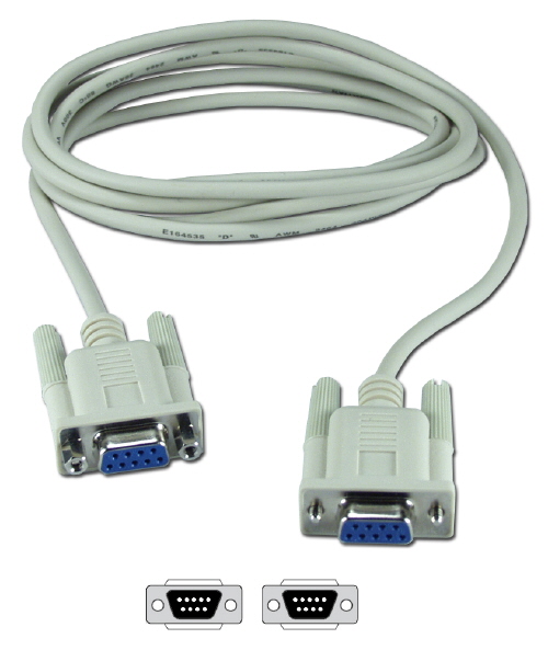

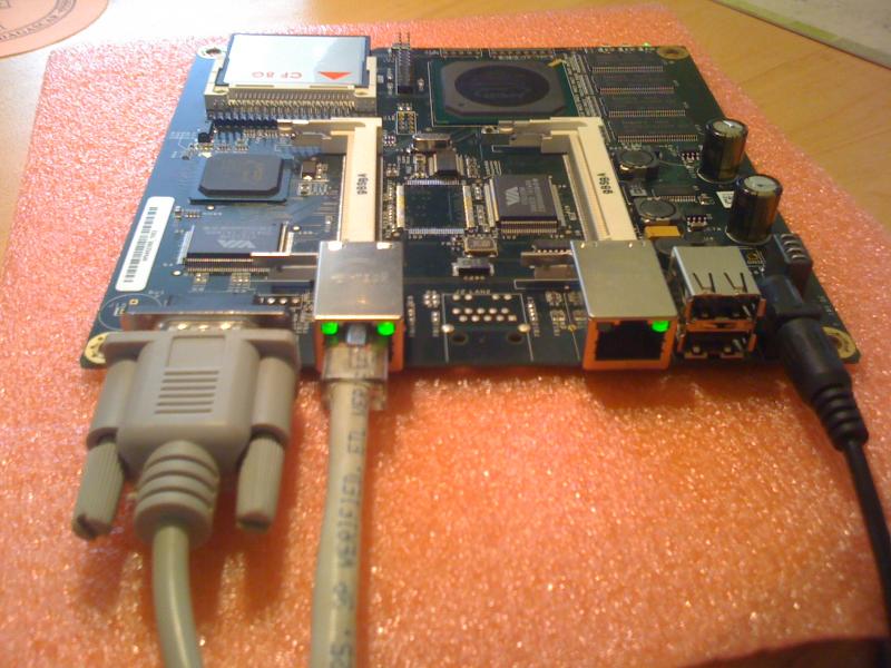

Pluger le CF dans la CM Alix
Brancher le câble null-modem Si vous n'en avez pas il est tout a fait possible de le bricoler vous-même.

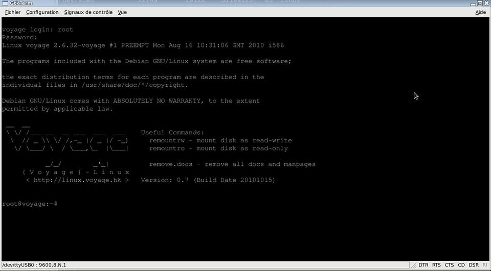

Lancer GTKterm, configurer le port et la vitesse (mettez 9600)
Vous remarquerez que j'ai utilisé le port /dev/ttyUSB0; C'est parce que j'ai un adaptateur USB/COM. Sur votre machine, si vous avez un port COM, ce sera de ce genre: /dev/tty0
Mettez la CM sous tension
Connectez vous en root Mot de passe "voyage"
Se connecter en ssh
ssh root@192.168.0.8 The authenticity of host '192.168.0.8 (192.168.0.8)' can't be established. RSA key fingerprint is 8f:da:e5:5b:c9:c8:dd:77:c6:ed:87:2d:71:eb:46:01. Are you sure you want to continue connecting (yes/no)? yes Warning: Permanently added '192.168.0.8' (RSA) to the list of known hosts. root@192.168.0.8's password: Linux voyage 2.6.32-voyage #1 PREEMPT Mon Aug 16 10:31:06 GMT 2010 i586
The programs included with the Debian GNU/Linux system are free software; the exact distribution terms for each program are described in the individual files in /usr/share/doc/*/copyright.
Debian GNU/Linux comes with ABSOLUTELY NO WARRANTY, to the extent permitted by applicable law.
__  __
\ \/ /___ __  __ ___  ___  ___    Useful Commands:
 \  // _ \\ \/ /,-_ |/ _ |/ -_)     remountrw - mount disk as read-write
  \/ \___/ \  / \___,\_  |\___|     remountro - mount disk as read-only
          _/_/        _'_|          remove.docs - remove all docs and manpages
    { V o y a g e } - L i n u x
     < http://linux.voyage.hk >   Version: 0.7 (Build Date 20101015)
Last login: Sat Jan 1 00:00:59 2000 root@voyage:~#
